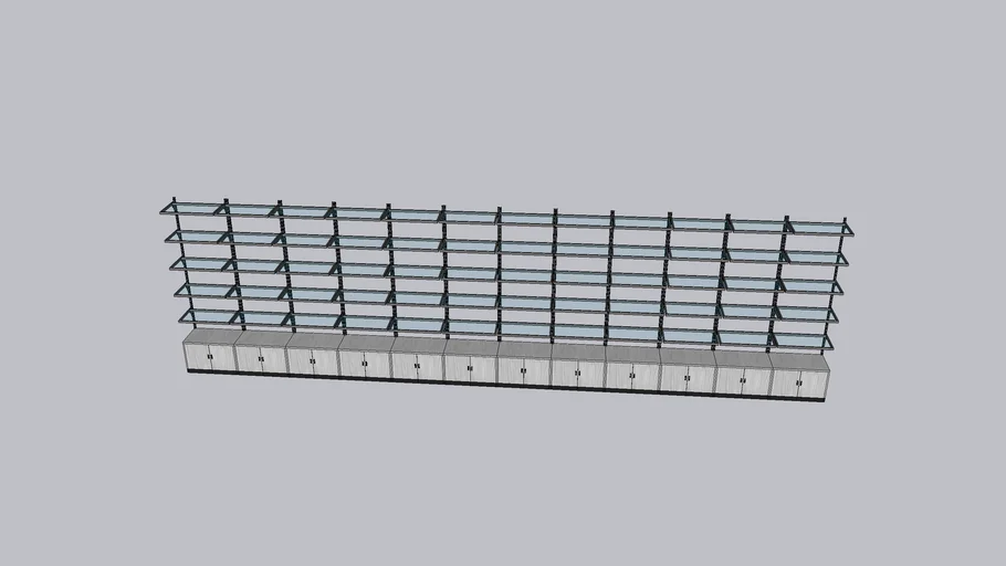

1. Made by MS Slotted channel for holding glass shelf 2. Frame of shelf made by (1"X.5") MS box with black powder coated paint. 8mm glass should be use in shelf. 3. Bottom shelf made by .5" gorjon board with blackish polish. 4. PVC board should be use in the lower part of the bottom shelf. Colour of it could be black. 5. Consent cobja should be use in the swing function of the shelf
