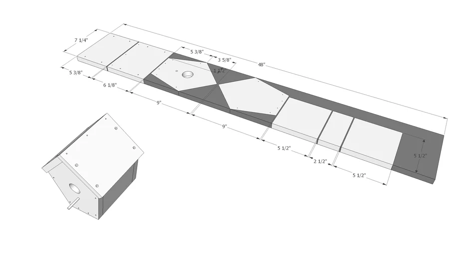

This is a model of an easy to build birdhouse. it uses common 1x8 lumber. a 8 foot 1x8 will make 2 birdhouses. you will need: (1) 48" 1x8 (Cedar is preferred, but any wood will work) (8) no. 6 - 1 1/2" wood screws - galvanized (15) 3d finishing nails, hot dip galvanized (1) 1/4" diameter wood dowel (you can whittle one from the wood scrap!)
