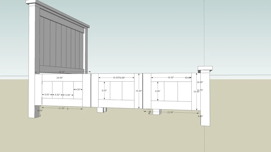

The area for the mattress is slightly too small. You might want to omit the 1x2 along the edges or add some facing on the outside of the drawer/storage openings instead. I built this bed and it is VERY HEAVY.
