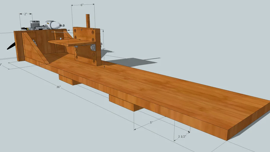

This is a quick and simple engine test stand I plan to build this spring. The cleats on the underside are made to clamp into my Black and Decker Workmate® bench. The firewall is a removable sacrficial front plate to allow for wear-and-tear and change over of different engine sizes. There is an adjustable tank platform and throttle lever. Consider this a guide only, I haven't worked out all the fasteners and other details yet. (The engine and pushrod are borrowed from the Hobbico Superstar 40) #Black_and_Decker #Engine #Hobbico #Nitro #Radio_Control #RC #Test_Bench #Test_Stand #Workmate
