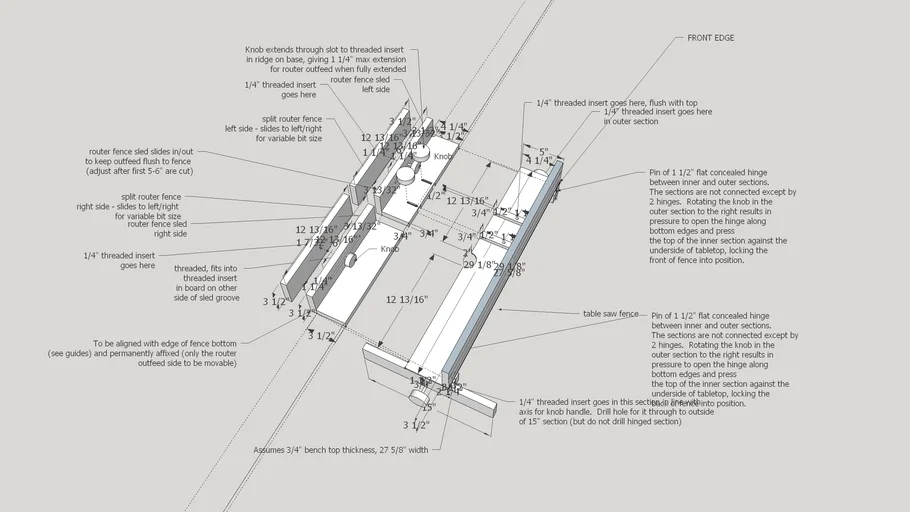

A split fence designed to work with my SkilSawAndRouterTable Sketch-up design table. One side is a solid fence intended for use with the saw, but the fence may be turned around to use it for routing in the middle of a piece. The other side is adjustable on two axes for use with a table router. Assumes 3/4" bench top thickness, 27 5/8" width. Built and tested, design revised to reflect corrections discovered in build. NOTE: I am using this fence now, with some issues. Make sure at all points in building it that all surfaces are LEVEL and SQUARE. It still has issues gripping the table and not sliding when pressure is exerted against it. I placed some rubber electrical tape on top of hinged gripping surfaces behind the end knobs to improve the hold. I always measure squareness to the bench before tightening, then may clamp it to table as well for router use.
