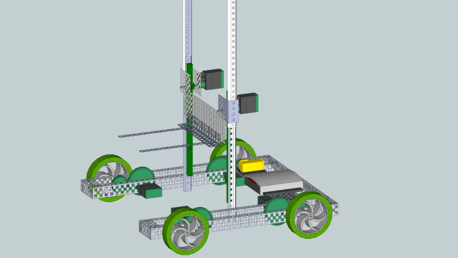

This is an example of a simple robot. It shows how to use linear sliders. It has 4WD, and is geared up so that it is slightly faster than an ungeared robot. To fit within the 18 x18 x 18 competition limit, the forklift will have to be at the lowest position at the beginning of the match, but I don't recommend this robot for competition, obviously. Wires, fasteners, and bearings are omitted in this model. #Clean_Sweep #forklift #FTC #linear_slider #rack_and_pinion #robot #VEX #VRC
