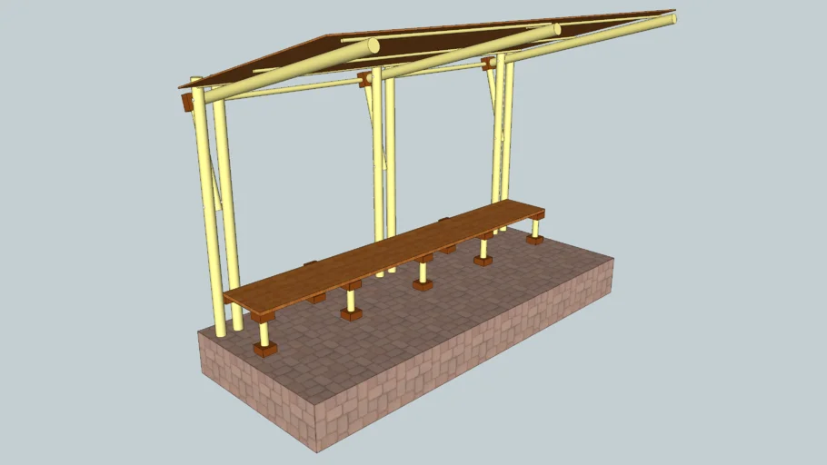

Bus shelter made with bamboo and country wood. I have used 3" dia and 2" dia bamboo poles for this. The wood can be any species of non forest timber locally available. The platform can be made with brick and mud mortar. Locally available stone can be used for cladding the platform and the flooring. Bamboo mat board can be used for the roofing element. The seat can be made with loaclly available woods in a slab or by using strips. The nails are made with turned wood. #bamboo #Bamboo_structures
