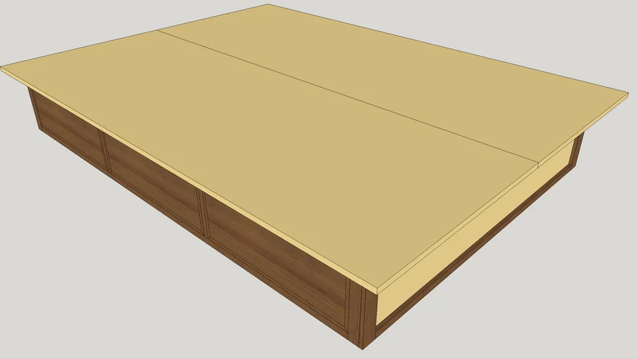

These are complete working drawings to build queen sized platform bed frame. You should download both drawings. Bedframe - Queen with storage.skp Bedframe - Queen with storage - detailed.skp Platform bed for foam mattress. Each piece is a component, making it consistent with Cutlist or CutMap plugins but you'll have to select your material type. I faced the foot board with veneer, not shown here. Included is the hardware required. I assembled with furniture bolts and barrel nuts for better strength than screws into plywood edges and used commercial drawer glides. Four storage drawers, but you can easily add two more in the empty spaces. I used only four because we didn't want to have to move night stands to access the additional two drawers. NOTE: I did not allow for clearance between drawer face and face frame. Every furniture maker has his/her own preferance for the amount of clearance they like. Just trim the finished drawer face to your preference. I did not include drawer pulls as my design used flush mounted (recessed) pulls, requiring a routed out pockets (not shown here). Modify as you wish. Comments welcome. #bed_frame #bedframe #platform #queen_size
