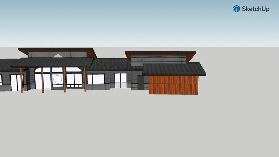

The difficulty with this ones it seems is when you look from back of house. Because the back wall of garage is angled it looks like a mistake; where that wall meets the shed roof- because your eye is expecting the shed roof to run the length of that wall perpendicular to it (like at front of garage). Would likely want to raise the shed roof so that there is 3' gap between it and shed roof line.
