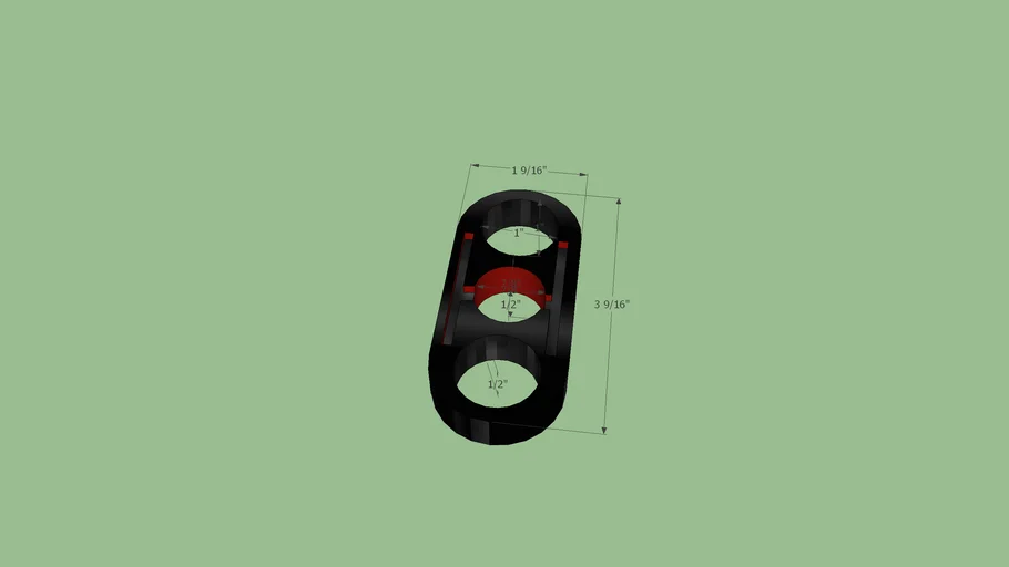

Sharky,
It is scaled to the right size perfect for 3D printing, but for 3D printing you have 1. Go to the Extension Warehouse (the box with the diamond coming out ) 2. Then go to the search bar and type in sketchup STL 3. Click on SketchUp STL ( probably the first one ) 4. Then click install, agree to the text ect. 5. Then click close and it should be installed HOW TO DOWNLOAD FILE AS A STL FILE AFTER THE FIST 5 STEPS! ------------------------------------------------------------------------------------------------------------------ 6. After Finished with your project and steps 1-5 7. Go to FILE then go to EXPORT STL 8. Then a box should pop up 9. Then go to the drop down menu on the export unit, then (for the US) click inches 10. Then DON'T TOUCH the export only current selection 11. Then DON'T TOUCH the File Format 12. Then Click EXPORT 13. Then put a file name for a certain file and remember the file 14. Then GO AHEAD 3D PRINT IT AND HAVE FUN!!!!!!!!!!!!!!!!!!!!!!!!!!!!!!!!!!!!!!!!!!!!!!!!!!!!!!
