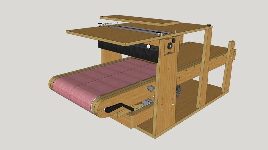

This is the 3rd iteration of the drum table plan. Please refer to the other plans for detail about components. Dust collection should work reasonably well with a large shop vac. What I haven't mentioned is that the sanding drum needs to rotate clockwise when viewed from the feed table crank side. The entire drum assembly can be rotated 180 if your motor's rotation cannot be changed.
