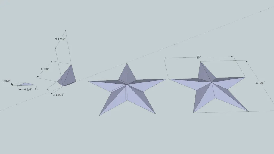

Each Star is made up of 5 sheet metal components cut and folded to the dimensions shown. Note that each segment has a tab that underlaps the adjacent segment. The segments are welded from behind on the edge of the tab so no welding is visible on the face of the star. I've also included dimensions for a pattern that can be cut out and used to make sure the segments are folded to the right angle. #3D_star #star #texas_star
