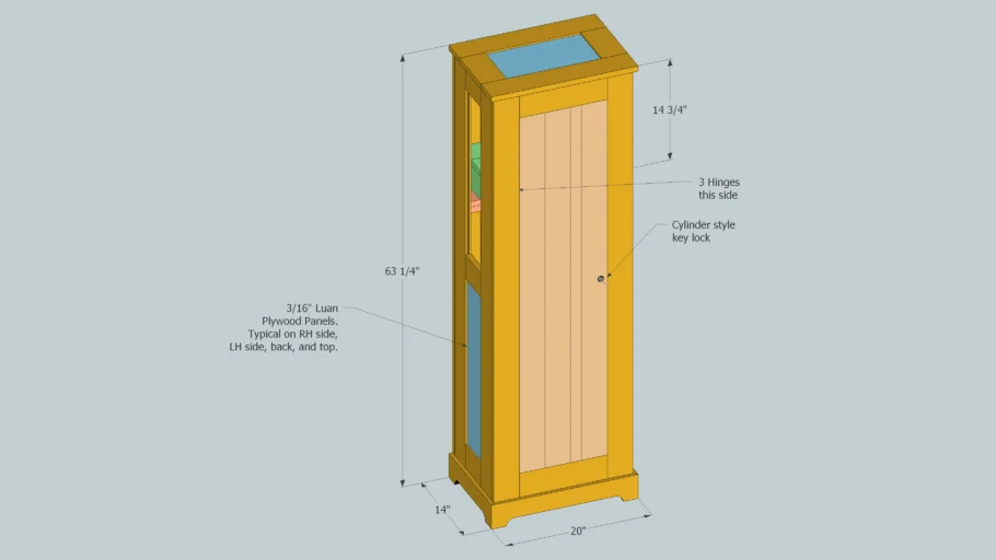

A relatively simple wood gun or rifle cabinet. It uses low-cost 1 by 4 inch pine boards for the entire cabinet (except for the 3/16" thick Luan Plywood floating center panels). Design can be widened to hold more rifles, or the height can be increased to hold longer rifles.
