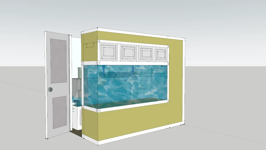

The main tank will not have the usual solid wall of Live Rock, but will leave ample swimming room to allow schooling and larger fishes space to thrive. The parallel sump on the adjasent wall will contain the rest of the systems life support eqpt LR/LS in its illuminated 80 gallon main chamber.The long sump will also feature a refugium with macro algae, copepod brewery, in sump protein skimmer plumbed to the sink drain and uv sterilizer. Under floor pump water return to main aquarium. Main tank gravity overflows in or on wall via pvc to the sump.The small water cube across from the sink will be a 10-28 gal new specimen /quarantine tank that is not connected to the main system to avoid disease contamination. Also (not shown) is a 30 gal saltwater batch mix/transfer tank which will be in the cabinet of the main aquarium and will be heated, plumbed for mix/tranfer directly to the main tank. This tank will feature the ability to utilize concentrated waste removal via wet skimate with the protein skimmer, by which the mix batch tank will replace pre-mixed saltwater change of 30 gal weekly. RO/DO from basement to sump for evaporation auto-top off. MH/PC/LED lighting with fans for tank/sump. Ceiling HO power exhaust fan. Louvered entry door. GFI electrical and ballasts contained in louvered door cabinets above tanks. Wave maker system and pwer failure back-up for minimal life support.
