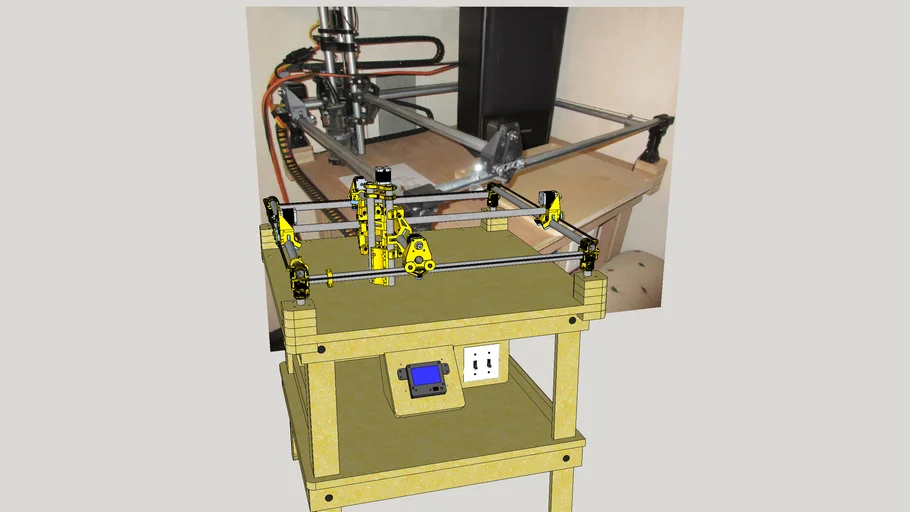

File used for a real-world build based on the MPCNC. Anchors on the four corners eliminate the original design's wobbly leg issue - but none of the other issues with respect to flexible 3D printed parts, 608 bearings running on steel, and flimsy rails - which is why it ended up a speaker stand instead of being used as a router. Don't build this POS, it ended up being a speaker stand until it was stripped and tossed.
