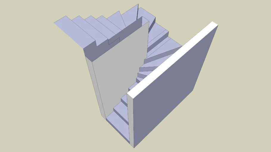

This staircase has a 180 degree U-turn. Problem: how to fold the steps around the turn. Measurements: total height: 16 steps @17.5 cm height, 28 cm length, 90 cm width; 20 cm between steps Material: still open - could be wood or concrete #stair #staircase #stairs #Treppe #Treppenhaus
