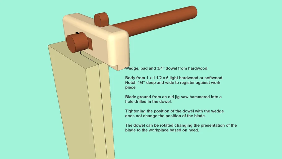

A marking gauge for woodworking. Have not built it, but hope to some day. I have found that the contact surfaces of most marking gauges are too small. I have also found that tightening the position of the extension often moves the extension slightly. This is my idea of how a better marking guage would work. I worked extra hard to make this an efficient, low file size model. #marking #marking_gauge #marking_tool #woodworking
