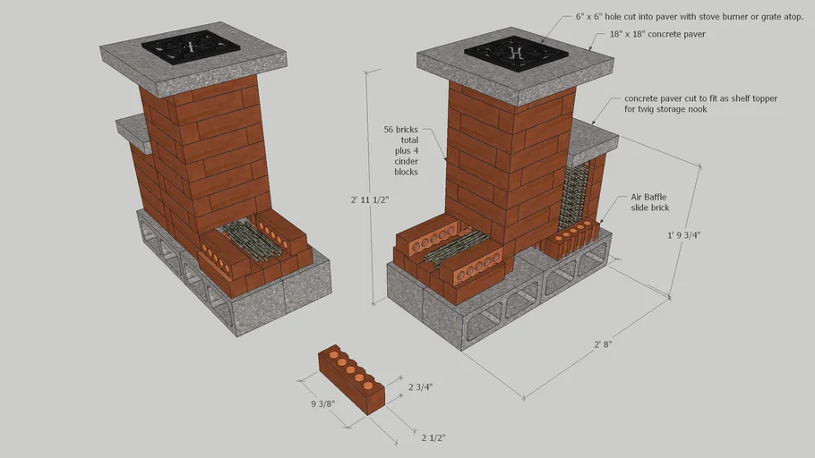

This is a small brick rocket stove I designed so I could use up spare brick I had in the garage. It also makes use of a few concrete pavers and some cinder blocks. For the burner, I just picked up a replacement one from the hardware store. Works really well with twigs. You can increase the height of the chimney as you like, this version get's you to about 2'-9" high...plus the additional height the cinder block you use gives you.
