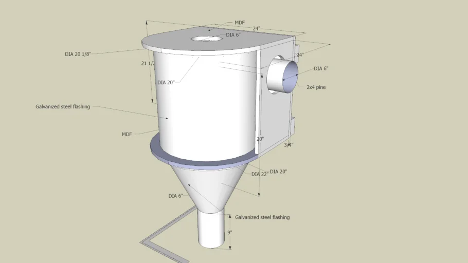

Dust collector for small to medium shops. Tested with a 2HP engine with a 6 inch single port, should work for one slightly larger, or down to 1HP depending on your length of duct work, the size of the chips generated, and the vertical climb (translation: you aren't going to be able to pull a 1 inch cube up a 6 feet of vertical 6 inch pipe and then drag it through 40 more feet of duct work with a 1HP engine) #collector #dust #dust_collector #LordLQQKs_wood_dust_collector #wood
