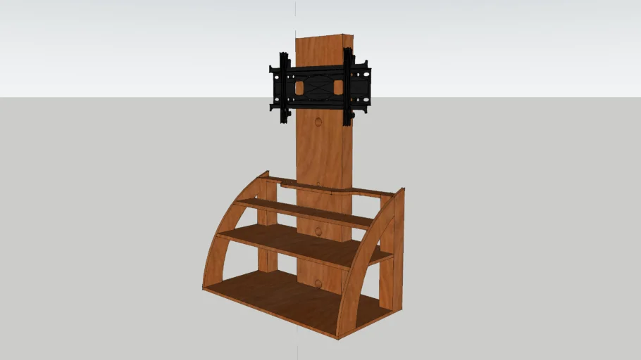

T.V. Stand/Entertainment Center, drawn to scale, has wall mount attached to the stand. I drew this off of the one I made for my living room. I used lots of dado's and flush cuts. The center column is made from (3) 2x4's. One in the middle and the other two spaced 16in O.C. so it is easy to mount the T.V. Wall mount to it. Then it was covered in plywood front and back and solid boards on the sides to conceal the edges. The rest is Solid Lumber but can be made with plywood as well. I drilled cable holes after I assebled the entire thing so i could decide where i wanted them ecactly and depending on where the t.v. fit. Hope you like it! #Entertainment_Center #flat_screen #flat_screen_stand #Furniture #Oak #shelf #stand #TV #TV_Stand #table #television_stand #wall_mount #Wood
