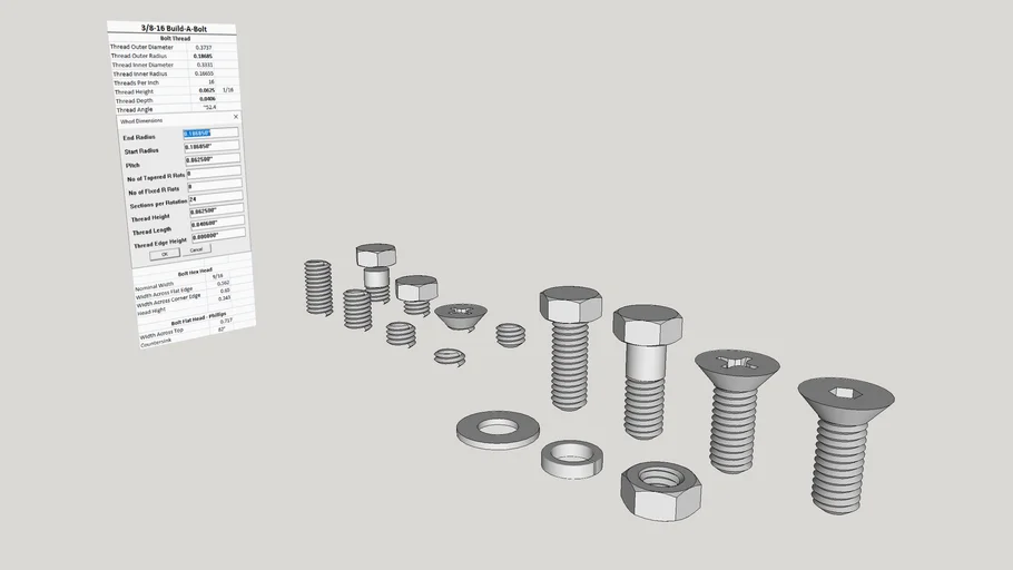

This is the beginning of my effort to create parts for configurable fasteners in popular sizes. This model's threads were created using an extension called Whorl. If you download this extension from the extension Warehouse you can create threads of any length to merge with the parts in this model. Alternatively you can copy and paste the threads in the model to build your desired length and then soften the joined parts. The thread and head dimensions are from ANSI specification tables available on the web from a variety of fastener vendors. The completed bolts shown are all 1" - #3/8-16 #Bolt #Build-A-Bolt #Fasteners
