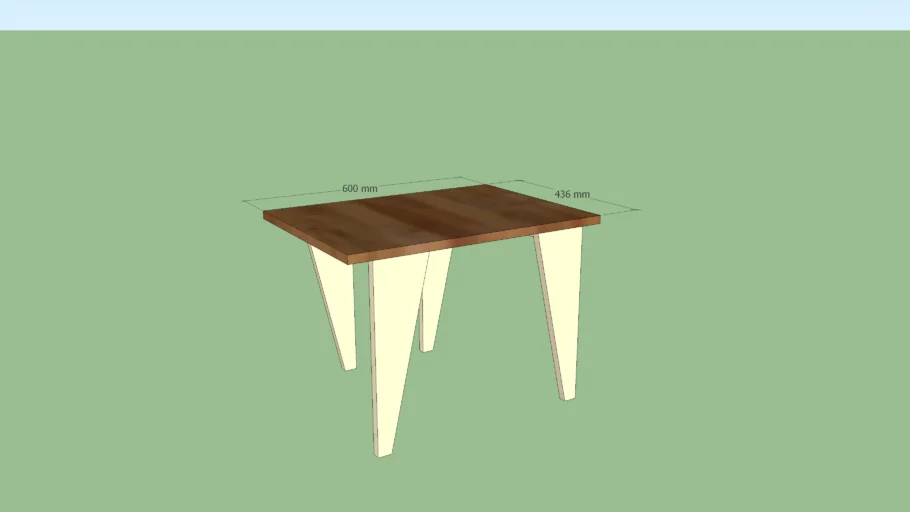

A small 60 cm*40 cm fold-away table.The legs can be folded under the table top using small door hinges and fastened with Velcro.When the four legs are open, lock the legs with two bars under the table. The crossbar is also fastened with Velcro.Only 1.8 cm plywood is used for this design, and the raw materials are easily available. It is only 3.6 cm thick when folded, making it very portable. You can use it as a camping table, a computer lift table, a dining table, etc ...
