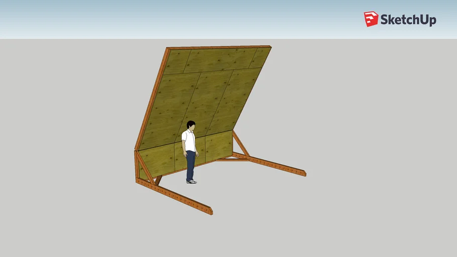

My preliminary design for a home climbing wall. 12' wide with a 3' kick board and a 10' overall length wall. Fully adjustable angle by building a couple beams to slot into the holes on the floor braces. The wall itself is reinforced with half-lap 2x4's to prevent torsion.
