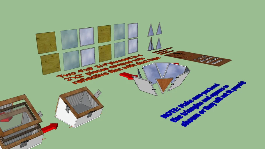

Assemble glass in frame and screw into top of oven. Attach door with screws on two hinges. Cut and assemble reflector from materials shown. The brackets, anchor screws, washers and wing nuts were displayed in step one with the other hardware. Note that, since the triangular parts of the reflector are 1/2" thick and the square parts are 3/4" thick, you will need a couple of extra washers on the triangle side of the bracket to attach them firmly. #solar_cooking #solar_oven #solar_oven_construction #solar_over_assembly
