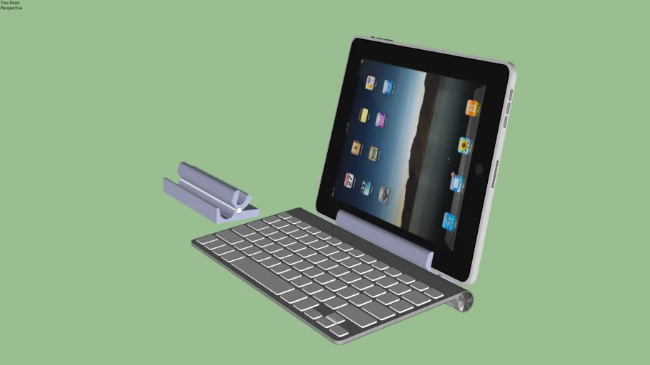

A stand that attaches an iPad to an Apple Bluetooth Keyboard that allows for both Portrait and Landscape clamping of the iPad and adjustment of viewing angle. The model needs a bit more work, sharp edges should be rounded. The bit extending to the back would likely need to be extended to keep the heavy iPad from falling over as the Bluetooth Keyboard doesn't weigh that much and probably wouldn't adequately counter balance the iPad fully if it was tilted back too far. What might be nice would be a recess/cutout along the thick portion that extends towards the back so the clamp holding the iPad could be folded flatter. I suppose if you make it hollow, you could have some room for rechargeable batteries so that you could hook up the iPad to extend it's battery life, then again, it would make the whole affair much bulkier. Could probably make this out of extruded aluminum or plastic.
