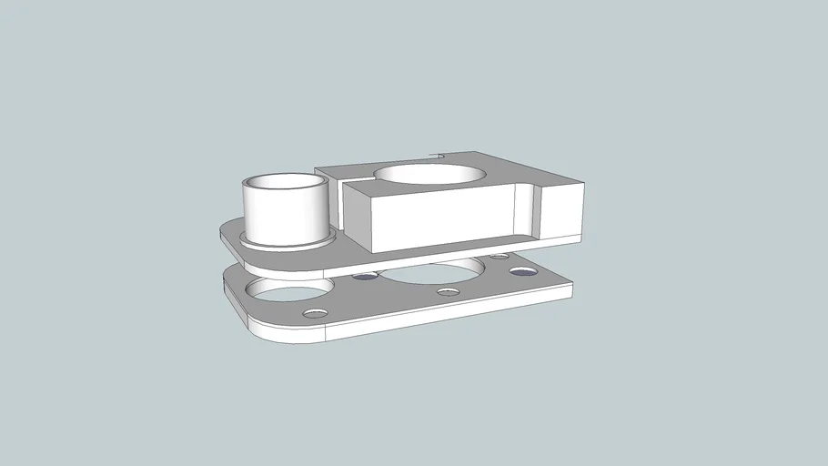

CNC Dust shoe w Kress 43mm mount. The mount is aluminum and can be found on e-bay. The upper plate is made in transparent polycarbonate and the lover in MDF. A skirt made of 2mm cutting foam can be stabled to the side of the MDF plate. The two plates are hold together by magnets (8mm dia x 1mm) glued in the circular holes. The connector for the vacuum hose is printed. #DIY_CNC #Dust_shoe #OX_CNC #Stainless_OX
