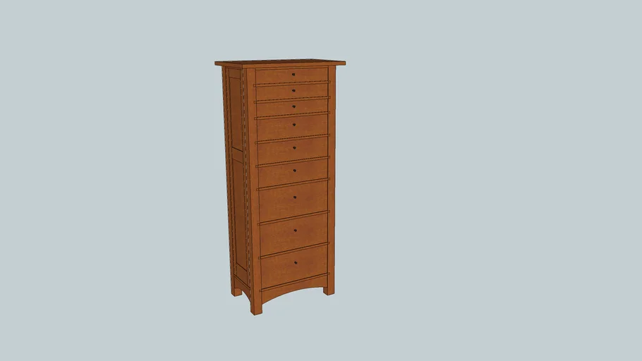

This is a 9-drawer lingerie chest setup to hold a substantial amount of jewelry. The side panels open to reveal a tall thin cavity in which long necklaces and chains can be hung from hooks. The top few drawers have divided trays to hold earrings and bracelets, and the medium sized drawers have sliding tills to hold larger objects and rings. It was inspired by the Harvey Ellis / Stickley style, but the design is my own. All of the proportions are based on the Golden Ratio (1.618) as a design experiment to see if the end result would truly be pleasing to the eye, and though I’m completely biased, it really does look well-proportioned. :) #armoire #arts__crafts #chest_of_drawers #craftsman #dresser #jewelry #lingerie_chest #mission #quartersawn_white_oak #stickley
