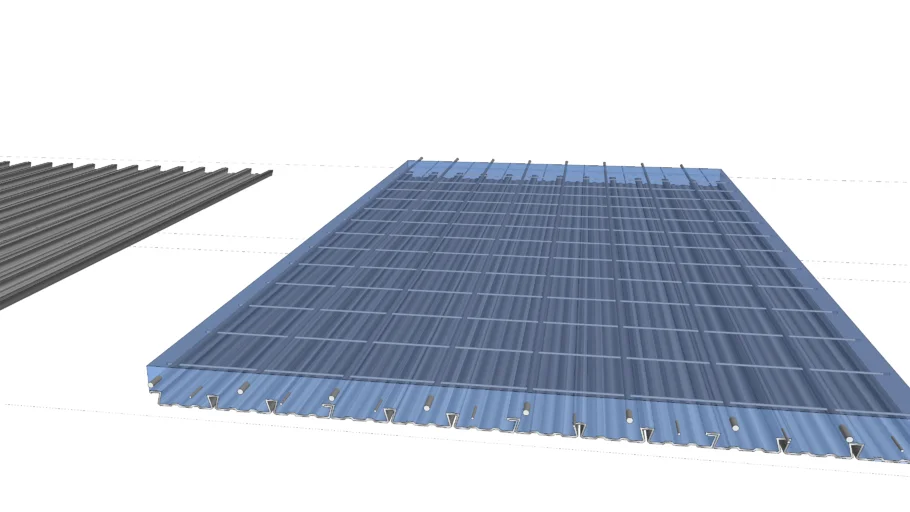

Concrete composite slab using Bondek thickness 6 mm, slab overall depth 140 mm, rebar steel: wiremesh 8 mm 2 ways 300 mm spaces, and longitudinal rebar steel 19 mm at 300 mm spaces #bondek #composite #plat_lantai #rebar #reinforced_concrete_slab #steel #wiremesh
