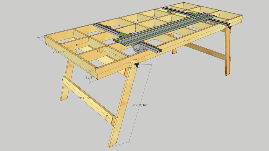

This is actually a model I made before I built a version of Roger Muller's design. I liked a table he uses in one of his YouTube videos so I built a Sketchup model and then built the table. It's a very handy work surface designed for quickly cutting down sheet goods right off your truck and before they go into your shop. It works for a variety of other purposes and is particularly good for clamping with the open design. This model is created and published with his permission. Beware - there may be typos or inaccuracies, so check everything. If you have improvement ideas let me know. #Festool #Parallel_Guides #Sheet_Goods #Workbench
