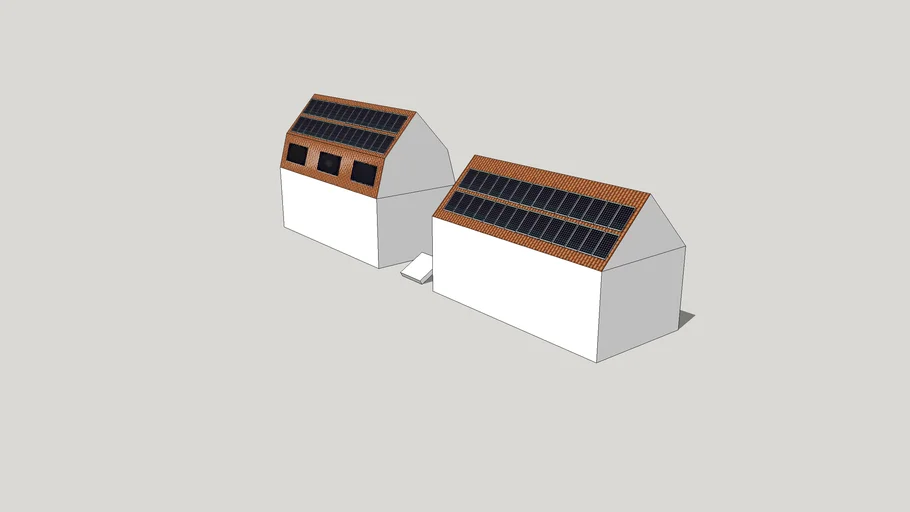

just a demonstration of how the sun impacts the solar thermal panels on the dutch barn roof at 90 degrees on the shortest day, when you need it the most... calculated by adding 22.5 degrees to the latitude (the difference of the tropics)
Solar Photovoltaic are set at 47.1 degrees for this latitude (51.5 degrees north)
