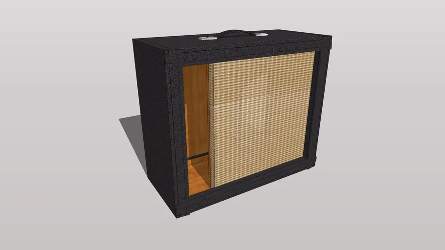

These are plans to build a Silvertone 1472 Guitar Amp Cab Replica. It uses 3/4” pine instead of 3/8” Cardboard, and has a 3/8” Ply Baffle. It’s designed 2” deeper to allow fitting other 12” speakers, otherwise the interior dimensions are the same. These plans will also fit a 1482 Chassis as well. The front Facia should be built by using 1-1/2” X 1/2” door casing of your choice -(as long as you think you can tolex it) mitered to 45 degrees at the corners and nailed and glued to the base cab before covering. The Tolex can be your choice as well as the grill covering. Also need some feet and a handle. #1472 #1482 #Guitar_Amp #Replica #Silvertone
