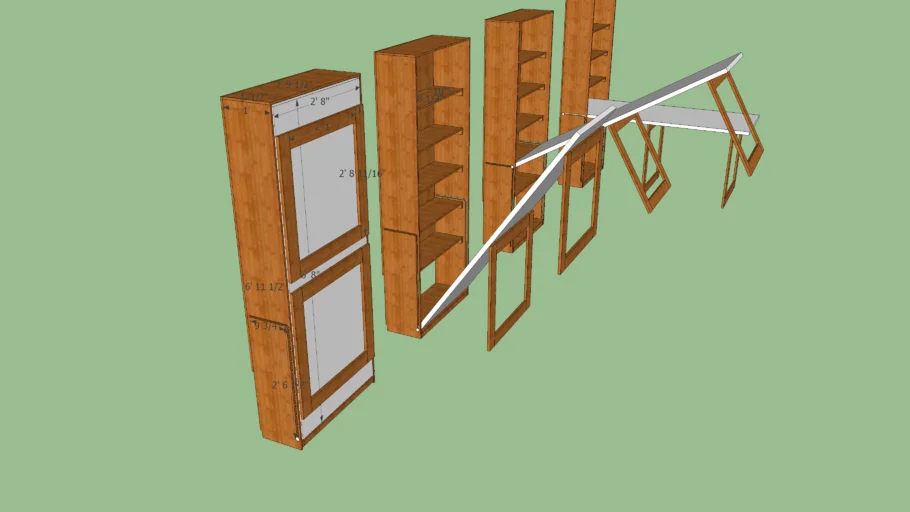

I need a table that is big enough (this is a 32" x 80" hollow core door) and comfortable enough (32" high) to work with quilts. The catch is that it has to get out of the way easily when I have company over... sewing room = guest room. The table slides up through vertical cuts in the sides, locking into place on horizontal cuts (a bolt will be sticking out of each side). The movement of the table top is illustrated. #craft #folding #hiding #moveable #sliding #table
